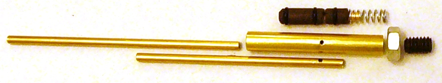

This is how I will be making my regulator. Not put together yet, but it is much like the commercial diagram initially posted, so you get the idea. Ignore the wire across the middle.

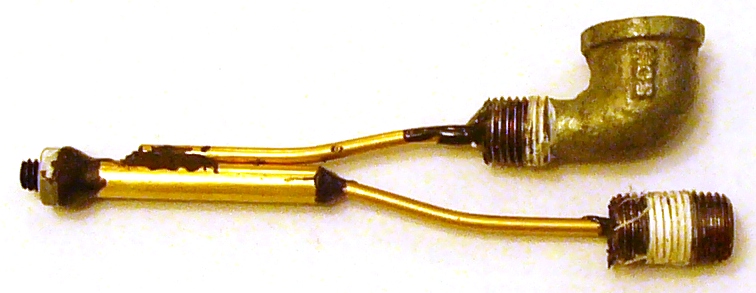

Scrapped the previous plan. This is how it ended up coming together. It's very similar to the one Ragnarok post, just not in a tee and without an airspring. For perspective, the fittings are 1/4".
It was actually pretty easy to make, if a bit fiddly trying to epoxy such small parts. I had to sacrifice the o-rings used in forming the piston, because a third of the o-ring thickness got cut off when I was shaving down the epoxy.
It is designed to meter at around 50 psi, though where it actually ends up and how adjustable it is remains to be seen. I measured the spring strength by placing a 750 gm block of cheese on it and seeing how far it compressed :lol:.
I'll test it out tomorrow when the epoxy is cured.
