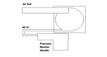

My vortex design:
Edit: I know its not good, and I could do what you said but my dad said we might be getting a new compressor (35 Gallon).
Vortex Marble.jpg (6.38 KiB) Viewed 5209 times

sputnick
Posts: 498
Location: Ontario Canada
Sat Jan 31, 2009 9:57 pm
yea no.
I'm telling you, you will be dissapointed, unless you have a MASSIVE air supply, you will not be happy with the results, I can almost guarantee it.
