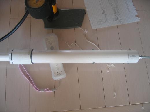

I want to tell the details, i am making the diagrams now, i been buzy because i was working on my prototype.
Okay, maybe this thing already got posted, but if yes, why dont evry spudfiles member dont have a gun like this? its able of full auto and semi automatic, you can even set it for 3 rounds burst.
The gun is actuated by an 3/4 inch electricaly activated sprinkler, so , with a 555 timer, you can set the firing timing you want, very simple.
The paintball loading mech is not on paint, but i am shure you can understand .
The cool thing in that is that you dont need any special modded pipes or pieces, the piston is 1 inch, its casing 1 1/4 and the whole casing 2 inch.
The paintball barrel(not in diagram) is a 3/4 inch cpvc pipe, wich fits paintball PERFECTLY.
It can work with a air compressor or co2 bottles, but i will have to find the the regulator and all that, wich i think will be the hardest for me.
Here it is
Here it is
The design, only look at the loading mech, the other is wrong
prototye close position
the air escape holes
prototype and the spring
prototype
prototype
THE PROTOTYPE ON ITS AIR POWER SOURCE( MY SNIPER :)

...Isn't that just a bfb?

maybe but i never saw a cannon that used this sort of valve.

Search before you lay claim on something.
I've seen a sprinkler valve used (in a spud gun specifically) to be actuated with a timer circuit based on a 555- i.e. it's been done before. The blow forward bolt is also in use...E.g JSR's designs and Clide's semi.
Both been done, but I don't think they've been combined if you want to be technical.

Okay, right, i'vebeen excited for nothing again, but it is still (for me) the easiest way to make a full automatic paintball gun.
