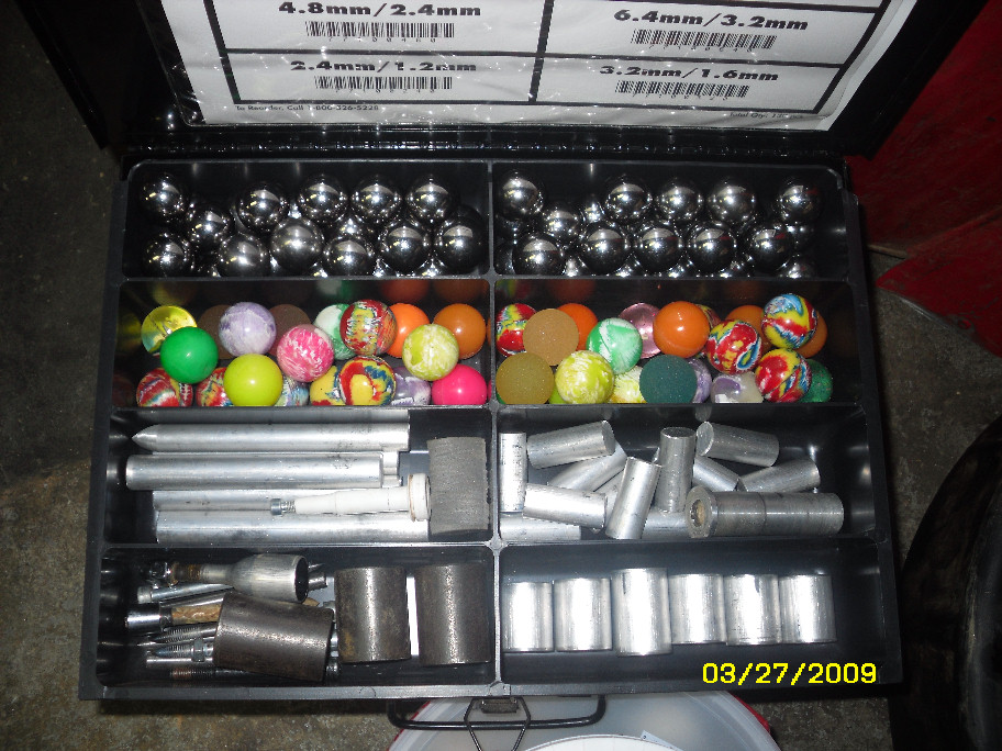

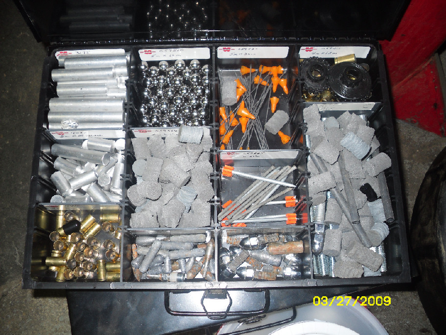

And nice organizers...hopefully we'll get to see some damage with those ball bearings.
REAL Damage will have to wait until I get some hpa, it does great with light projectiles, but the bearings REALLY need 400+psi to do impressive damage...daberno123 wrote:Looks great I can't wait to see it with the wood. How do you plan on concealing the pilot/fill end? Making a handle around it could be tough.
the handle will make JSR proud, it'll be made out of epoxy, with a vented black rubber button cover over the button, and I'm thinking about making the fill side so that I can use 12g co2 with a screwin piercing adapter for full stealth mode... use the little grey sabots in the box in front and behind the bearing(they are really tight), and then, if the occasion arises to ventilate something, screw in the co2 cartridge to fill and push the button to fire... Slick, huh?
