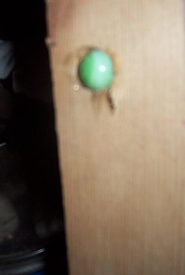

No vid, but a view of the latest improvement...and...a very nice embedded marble...
Cleaned up the Tee.<br /><br />How you like it now?!?!
Cleaned up the Tee.
That's pretty hard wood, not crappy at all..
Over 3/4 is in there!
