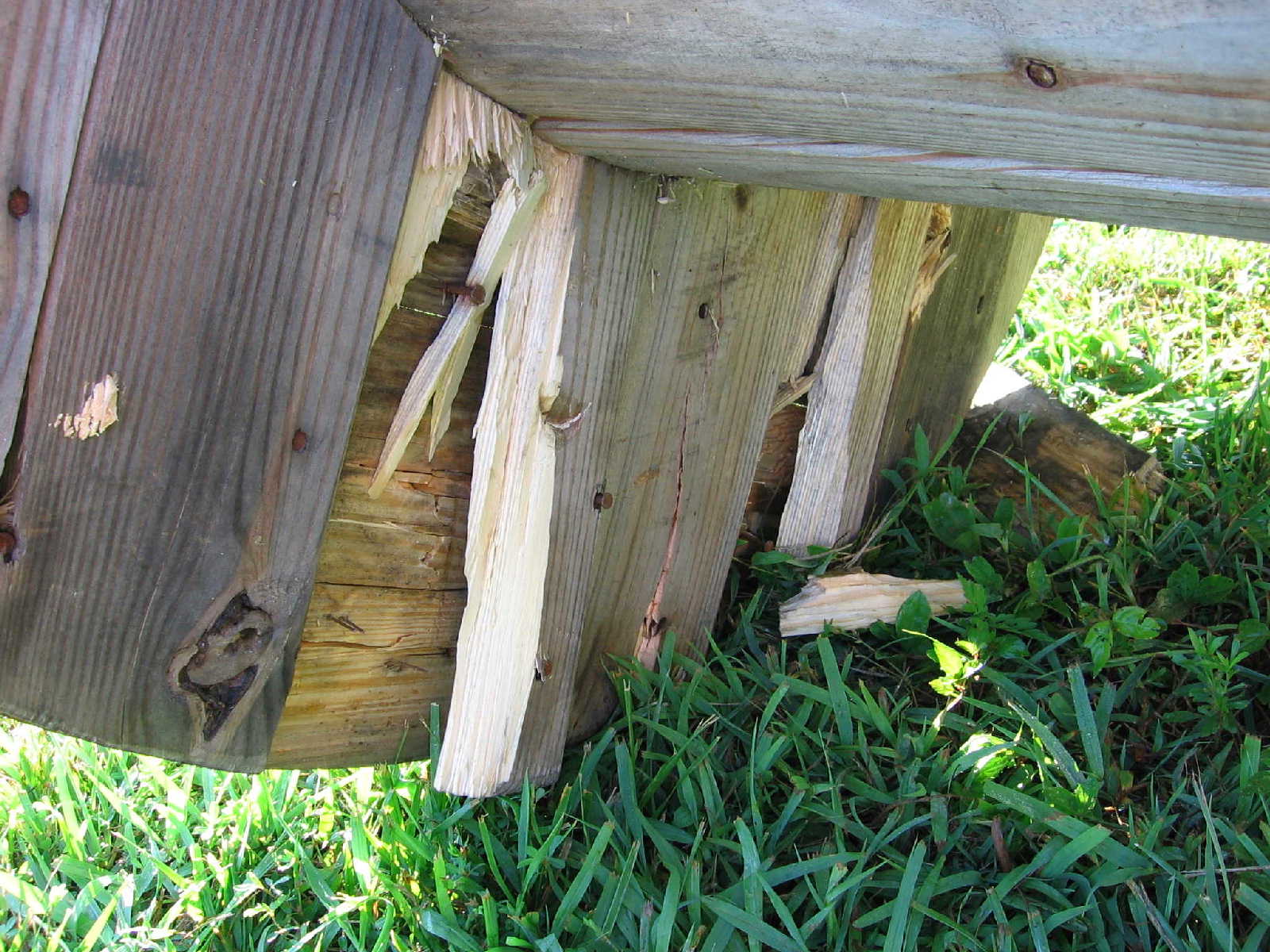

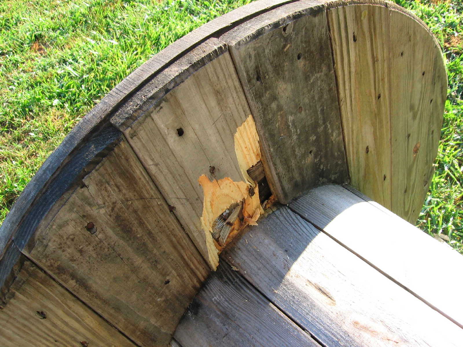

As you can tell by the pics, the wood is not rotten and that's a ' steel ball for size index...

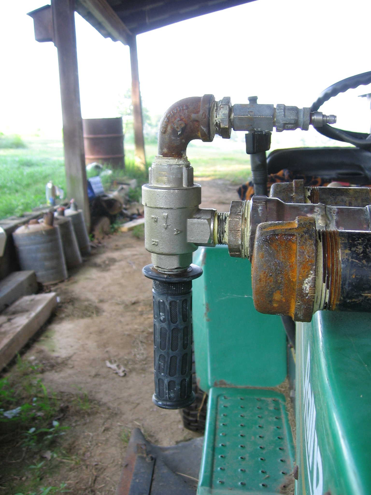

Here's the updated triggering mechanism I built to replace the blowgun triggered broken one.....
Also pics of the decimater "field stripped", the piston(showing the toolie design), and the piston/pilot chamber( gives a good visual of how I build the "cup seal" rear piston seal that is so effective for allowing only one way flow for filling and 100% seal against backflow on firing)...
The reason for the big rubber stopper behind the barrel sealing face is because with unregged co2 and a washer directly behind the sealing face, a coupla shots would destroy the sealing face by turning the barrel into a hole punch, the rubber stopper helps cushion against that....
Do you think a 3/4" qev is overkill for a 2 cubic inch pilot volume???
