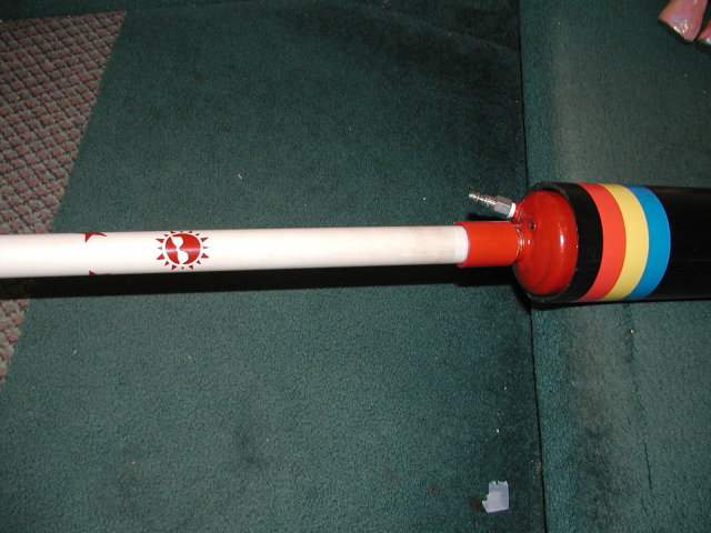

Neatness counts. Here is my small launcher nested in the barrel of the larger launcher. The 1 inch barrel is primed with purple primer and glued. I respect neatness and attention to detail. Well done.

There's a difference between primer on the outside of the gun, where the world can see it and it being on the inside of the gun, where you might see it when you breech load..Technician1002 wrote:Neatness counts. Here is my small launcher nested in the barrel of the larger launcher. The 1 inch barrel is primed with purple primer and glued. I respect neatness and attention to detail. Well done.
But yes, neatness counts..
