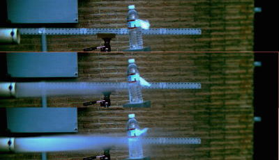

If my photography is any indication, I have gotten well over supersonic air blasts from the 2 inch cannon. At 1,000 frames a sec, the front can be seen at over Mach 1.5. The flow looks to be traveling at over 4.5 feet in 2 ms.
3 frames of video 1 ms apart.  Shot at 1,000 frames per second.  How fast is the flow?  The marked pieces of tape on the ruler are 1 foot apart.

Ragnarok wrote:The other thing that gets on my nerves a little is that people seem to think that GGDT is a substitute for genuine real world results.
As always guys: Simulation < Genuine results
True enough. However, in some circumstances "simulation" gives better and/or more useful results than "genuine results".
Usually, in a simulation you can make small changes in the parameters and get answers much quicker than with "genuine results". To the extent that folks are too lazy to get "genuine results", "simulation" is the only answer.
An example would be the "mine sized chamber affect". Nobody, that I know of, has ever done a Latke type study on a variable chamber size on a fixed barrel combustion. The HGDT, and other, simulations are the only data we have.
In the real world, engineers generally use both simulation and "genuine results" to model complex systems. Both have their advantages and their disadvantages and both are useful. You get a better understanding of any system when you have both "genuine" and "simulation" results.
In the case of GGDT, I suspect GGDT is probably about as good as actual results for subsonic shots. When GGDT disagrees with actual results, I would first suspect that the parameters to GGDT were incorrect (valve flow and opening time, ammo friction and mass …) before suspecting a fundamental flaw in GGDT. Furthermore, when GGDT disagrees with actual results I would want to know if the difference is statistically significant. You really need to collect several replicates of the "genuine" data and do a statistical analysis.
A couple more big advantages of "simulation" versus "genuine" results; (1) Simulations don't have shot-to-shot variability. (2) Simulations give you some idea of why one set of parameters behaves differently than another. "Why" is often a more useful result than is an absolutely accurate prediction.
