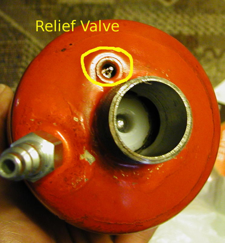

One of these might work.
At least it would make me feel safer knowing my tank won't Krakatoa on me.

Good idea.. The one built into my valve prevented my tank from doing that. A better idea is to design it to fill less than 80% (20% expansion space minimum) and have a safety pressure relief. For propane use about a 300PSI relief valve for safety.chenslee wrote:One of these might work.
I know the pneumatic guys use 100-150 psi's on their cannons to prevent "non-passive end of life failures".
The highest rated relief valve I can find so far is 200psi and it's $19. I know there has to be some out there cheaper.
