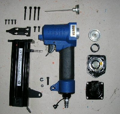

I'm assuming yours also uses a coaxial airchamber to push the piston and blade back (then venting through the piston valve piston)... mmm too many pistons
I had taken it apart and posted picson spudtech but the pictures have disappeared, but yeah, they're basicalyl all the same coaxial piston design. I attached a photo to the end of this post.
If that is the case could you not put your blowforward mechanism inside the body with just the breach sticking out ?
This is how I had modded mine to take the breech:
Basically very little dead space, the breech is accessible and I didn't have to mod the nailgun in an irreversible manner :)
