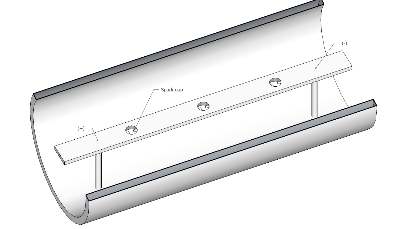

What about a design where the spark strip is simply supported in the center of the chamber? You could just put holes in the strip and place the electrodes in the center of the holes. I wouldn't think the thin profile of the strip would interfere too much with the flame expansion (but I'm just assuming that).
That's the technique starman uses in Triple Thunder. Seems to work.

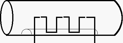

This is what I was thinking of.

I'd say niglch's sketch is probably about the best you're going to get from the bang for the buck perspective.
But so what?
It's not like it isn't reasonably simple to set up an arbitrarily large number of ignition points if you're using a spark strip (or strips). High voltage circuits are cheap and easy to come by.

Jimmy I like your design but the only problem I see is that it would be hard to service the sparkstrip if your using a small diameter chamber....
jimmy101
Posts: 3210
Location: Greenwood, Indiana
Has thanked: 6 times
Been thanked: 18 times
Wed Sep 16, 2009 10:12 am
theBOOM wrote:Jimmy I like your design but the only problem I see is that it would be hard to service the sparkstrip if your using a small diameter chamber....
Actually, I figured it would be done the way Latke did his. There's a screw at each end of the strip the goes through the chamber wall. The screws also supply the electrical path.
If you remove the 2 screws the whole thing will fall out'a the breech.
The strip probably needs to have either threads, or nuts permanently mounted to it, since it'll be nearly impossible to get into the chamber far enough to hold nuts while the screws are installed.
