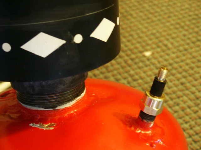

I am very impressed. One comment on the tank. I wanted everything serviceable without cutting. The Schrader is only a 1/4 inch close nipple. The schrader or quick connect for rapid fire is screwed onto the nipple.

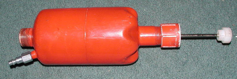

Tank with quick connect for the hand pump.  It's hard to hand pump and hold the connection at the same time.
Tank with schrader screwed on with the bottle rocket barrel.  Makes a quick fill from the compressor simple and can be fired without a connected hose.

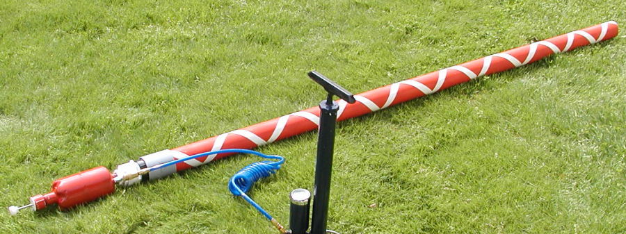

Typical field use with hand pump to prevent the air chuck from blowing off.  I used a quick connect instead.

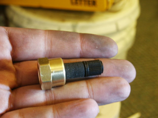

The coupling is industrial. You could put in a bushing, but the original is simply a galvanized 1/4 inch pipe nipple. Well it was galvanized until I got it to brazing temperature. :D
The schrader is simply a tire valve with the rubber cut down some and then put in a brass 1/4 inch pipe cap and screwed on. With the rubber, no tape or other sealer is needed.

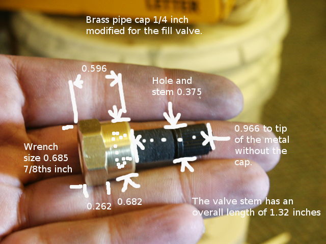

I took the fill valve measurements. See photo. The tire valve was turned down in a drill press to fit the hole in the cap. I left a shoulder on the valve just small enough to fit inside the 1/4 inch cap with a little pushing. The shoulder is only about 1/8th inch long. The rubber was trimmed flush with the end of the brass tube inside the rubber. The brass tube overall length is in the picture. This rubber shoulder provides a seal on the 1/4 inch pipe nipple without requiring any Teflon tape on the threads. It screws on airtight.
I bumped this so dewey would get the measurements for his library.
Fill valve measurements.
