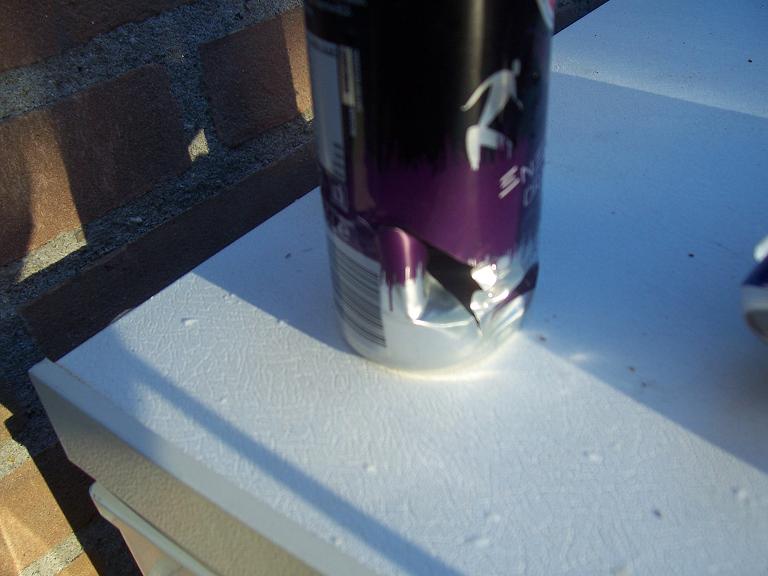

First I tried your penetration test on waterfilled redbull cans..and made it onto the fifth, without attempting to diesel..So by itself it is pretty powerful..No wonder..at over 500 psi!

I think my cans are a bit leaky,..<br />I might be wrong....
Left me very wet by the way...
Last can standing..well..not really..Both this one and the sixth flew off a couple of feet.The sixth was just dented a bit..Nr 5 is still dead!
