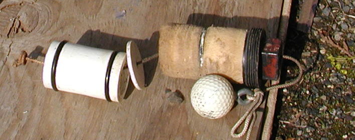

A very small bleed hole at the breech of the barrel will fix the loading problem. Drill a small 1/8th inch hole in the coupling near the sprinkler valve to let out the trapped air when loading. During firing the short duration prevents much air from escaping the small hole. My QDV cannons don't have a shaft seal, so they bleed off through the center of the piston out the trigger rod. I have very little air leak past it as it is under pressure during the shot for less than 20 ms. This ability to load tight sealing projectiles is one of the reasons I like my apple cannon over a traditional piston cannon.
