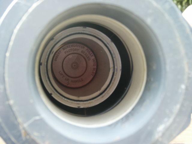

I'm up again. A few comments on the piston. If you have a piston that is difficult to seal, like this one, lapping in the valve is a solution. Make a long piston out of wood dowel that will fit in there and either use fine sandpaper or valve grinding compound and gently rotate the dowel in the valve area (snug fit) to wear the valve sealing face. With a little valve grinding compound on the valve seat then the piston face is mated to the valve seat in the same fashion.
Smaller valve seats are easier to do. Larger seats due to the size of the sealing area are much more critical to complete this step. In the attached photo, this process on the Dragon is shown. Note the sets of black marks on the radius of the valve seat. These are sharpie pen marks. The valve seat was lapped and sanded true to the valve cylinder by use of a piston with a sandpaper face. The seat was sanded until all the sharpie marks wore off evenly. When I started, several wore only a little. I marked often and checked progress until they all wore evenly. It is how I got the dragon to seal. Not the mark on the lower right is completely sanded off. It was my high spot. That is a 2.5 inch valve seat using a 3 inch piston. In the photo you can see one of the marks is worn down more than the rest. This was a high spot that not only provided problems sealing, but put a twist on the piston so it wanted to stick. This may be an issue you are having.

Dragon valve seat polishing marks.
