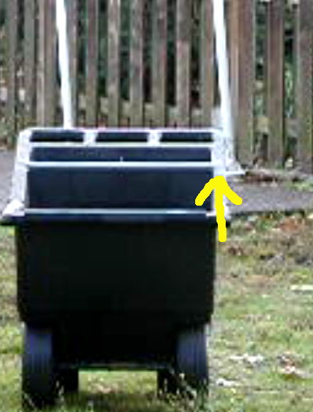

Edit, I played some more today and had much better luck on precision distance shots. Due to the size of my yard, I setup for some 10 yard launches. The change I made is I used a larger barrel and a foam sabot. This permitted less air than will empty the barrel to be used. In all my testing the sabot was never ejected. I don't have a stand yet, so I was simply leaning it on a sawhorse. After I got the distance dialed in, I grabbed the camera with low batteries and got a quick shot. The distance was right on, but due to using the sawhorse, I missed the center and hit the rim of my garden cart. With a fixed stand this could easily put the golf ball in a bucket at 10 yards.
