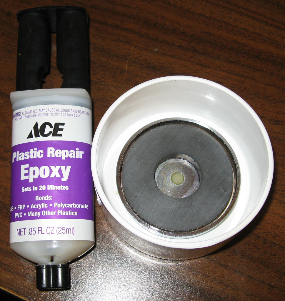

I used ACE Plastic Repair Epoxy (SKU 17394) for glueing a 65lb magnet to a 3in thinwall PVC cap.
MAN this stuff smelled so chemically when I was mixing it! But it works great, very very tuff, but not brittle. I'll be using it on my future launchers for attaching BBQ ignitors on PVC screw caps.
ACE Plastic Repair Epoxy, SKU 17394, 65lb Magnet & 3" thinwall cap
Holding canister with cap & magnet
