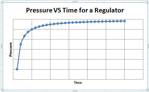

The regulator itself, by design, has a limited flow rate. It takes exponentially longer time per unit pressure as it approaches equalization between desired pressure and regulated pressure. To overcome this you need a holding tank of sorts after the regulator to have a "capacitor" effect if you will. The air coming from the regulator will continuously fill the holding tank while the hybrid takes up-to-pressure air from the tank.
- This is the tendencies of regulator pressure as a function of time. In theory it will never reach full pressure
 - Regulator Trend.JPG (29.84 KiB) Viewed 5042 times

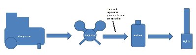

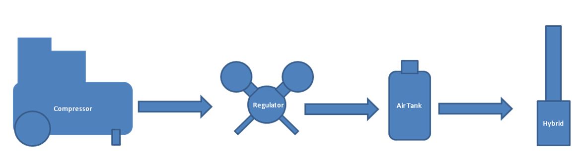

- This is the setup I'd reccomend
 - Air Flow.JPG (27.51 KiB) Viewed 5024 times

A pressure accumulator sounds like an excellent idea!! How big would the holding tank have to be? I am planning on having this be a full auto hybrid (using a type of blowback bolt with a piston valve). It will have a fairly low rate of fire - 5 rounds per second max), but it will still have to require a very high flow rate.

@RC: What model did you use to generate that curve?  The initial pressure ramp for a regulator should be pretty linear as flow is choked.  Depending upon the supply pressure and reg set point, it may decay as you show (if supply and set are reasonably close so flow is no longer choked).  It may decay linearly.  It may do all sorts of things depending on the specifics of the system.
Admittedly, this is not a problem I've studied in depth, but... Well, just looking for more explanation of where that plot came from.

The plot itself is just a negative inverse plot. I did no modelling to generate it. It is just a generic chart. (Hence no units) Logically it is the way a pressure regulator would work. I've also noticed this trend when I used a regulated pressure compressor for my T-shirt gun. Admittedly, the model better represents a regulator filling a pressure vessel. I could model it. However seeing as I am taking finals at the moment I'd rather invest my time studying.
						Note takenedit: Oh, and when you're dealing with pneumatic systems, you don't call them capacitors. You call them "accumulators."

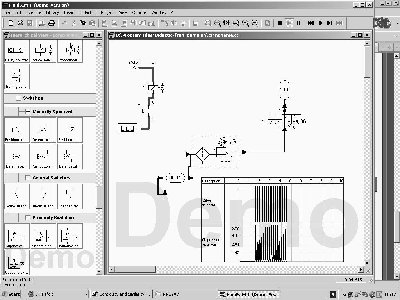

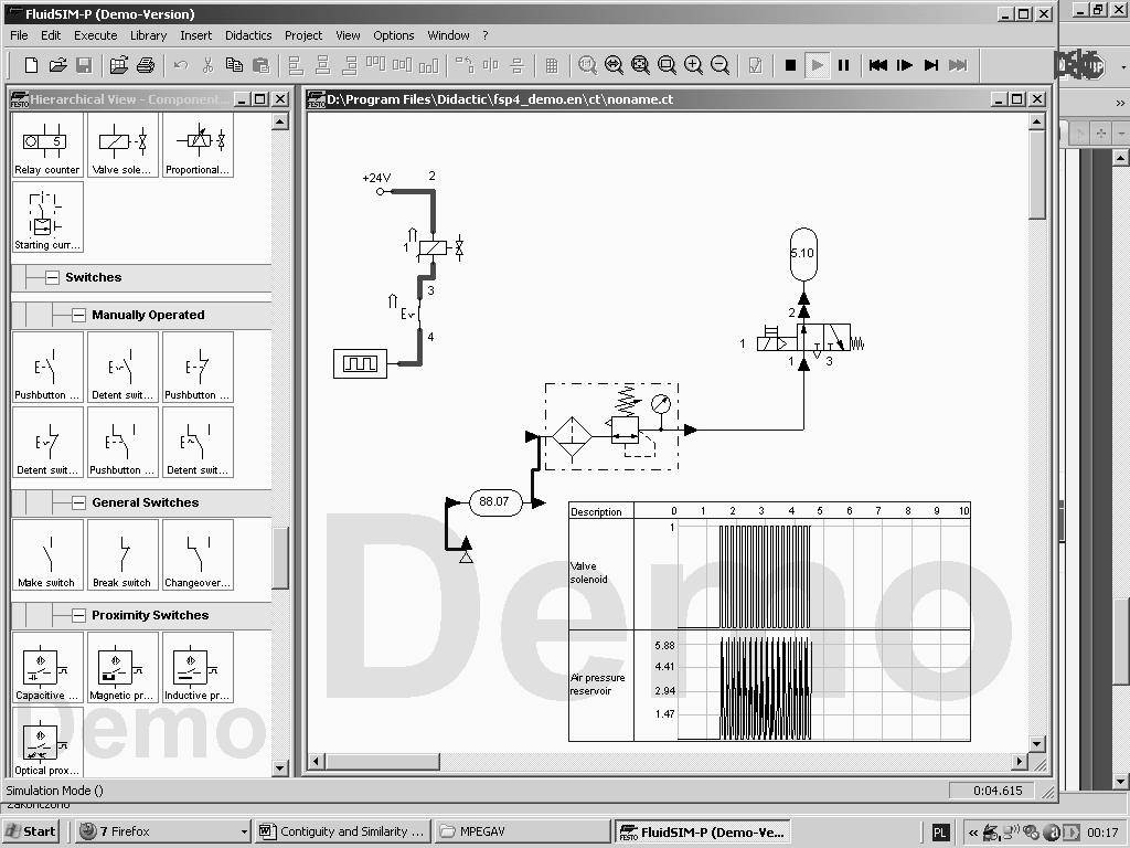

you could use fluidsim to model it... it's not as useful for us as GGDT but still you can simulate quite a lot of things
though you would need to know the exact flow rate of your reg and valves for its results to be meaningful

how do you plan to control each cycle ? with the use of electronics, right ? you can also build and test some simple electronic circuits with fluidsim, you know... nothing advanced but enough for your needs

- here is a print screen of a simple circuit that could be fitted on your gun.... the solenoid on the valve switches on/off at 5Hz rate and the regultor is set at 40 psi... as you can see it can't keep up when filling the metering pipe (100ccm volume).... when I add an accumulator an set the pressure at 36psi the pressure in the metering pipe is lower than 36 psi... so that's why I think that you have to use higher pressure
