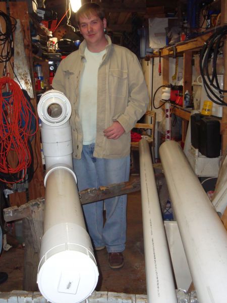

McCoytheGreater wrote:However 6' > 6'2".
Gorram it, you've broken maths.
Six foot somehow being more than six foot two aside, that is one beastly large cannon.
How exactly did you manage to measure the chamber volume to two decimal places though?
McCoytheGreater
Posts: 191
Joined: Tue Dec 15, 2009 1:10 am
Location: Mississippi State
Wed Dec 23, 2009 5:46 pm
Very very carefully. It should be 1492 +/- 3. theLesser figured it up for us. We're just sitting around waiting on the epoxy to cure before the spark gap gets tested and mounted. As to Artillerycreation's question, we are using clean out caps. We're modifying the end cap in the T to hold a chamber fan about 8 inches inside the T. Our propane inlet is mounted on the T. More stuff coming soon.

Just finished the chamber! The spark strip and chamber fans are in place and tested (I know the spark strip works because of the fireball that came toward me :D. ) All theGreater and I have to do is build the stand and carriage assembly, then glue in the barrel. Pics of the spark strip to come in the morning :)
McCoytheGreater
Posts: 191
Thu Dec 24, 2009 3:35 am
So here's a pic of the spark gap firing as well as the chamber with the T fitting installed. Would've saved this post till in the morning, but it already is morning. I just haven't gone to sleep yet. And it's a ballin' ass picture. With every new piece that goes on the cannon, the scale of this project becomes more and more real. It's friggin huge!
And the"slightly"Lesser.  Yeah.  It's a big build.
Here's the spark gap firing in all her three sparkish glory.
