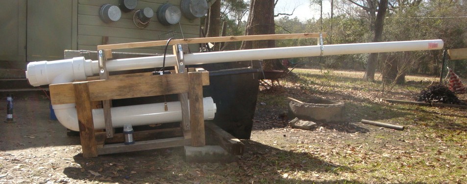

IT WORKS!!! theGreater and I have brought in the new year with a bang, a very loud bang. ME 1-05H works beautifully and has a surprising amount of recoil with just a light projectile (an empty soup can). Can't wait to test a full weight projectile in the monster! A video is soon to follow this post.

So the howitzer performs flawlessly. The surprising thing is that even with the weight of the gun it has a surprising amount of recoil. Even with light projectiles (soup cans, as mentioned above) there is still a full 12" of recoil travel. We'll be attaching the recoil springs and pneumatic return tomorrow, as well as performing a full scale test. The past nights tests were with empty soup cans. The next test will have 7oz.'s of Plaster of Paris in the can with a heavy projectile test to follow. We will also be measuring the muzzle velocity of the cannon with our high speed camera. Unfortunately all experimentation will cease after this week due to college resuming. Keep a watch, though, on the weekends. This has been a successful build for the time we have worked on it. A big thanks to all who have posted, made suggestions, and/or have warned us about this build.

So yesterday theGreater and I shot Cerberus with a full scale projectile. The sound that came out of the cannon was deafening and we got some very valuable data from this test.
This is what we gathered.
Muzzle Velocity (approx.)- 650~670 FPS
Weight of Projectile- 7.2 Oz
Distance (approx) - 175 yards @ low trajectory (20~25 degrees)
This test was done with the meter pipe charged to 85 psi. and the chamber fan was left to run for 20 seconds.
By this afternoon I should have some damage pics posted along with the high speed shot of this test.

Even with the bracing, we're going to replace the recoil springs with stouter ones and put bumpers at the end of the recoil rails to prevent a hard shock. get more springs for it. The ones we have definitely aren't giving the recoil reduction we'd hoped for. That being said, we definitely didn't foresee that amount of recoil in the designs. Luckily the gun itself probably weighs 80 lbs. Not necessarily light, but with the weight, the recoil probably isn't as bad as it could be with a lighter gun. Looking at muzzle brake designs. We're hoping to reduce the recoil by at least 25% Anyone have any suggestions for the construction? We're trying to keep it lightweight, yet effective.

This is our recoil system.  The springs are too long and bent down.  The black rails are what the gun rides on while being shot.
A view from the front.
The Howitzer from the left.
