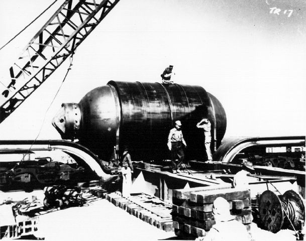

Although... there WAS an all-steel chamber built to contain the Trinity explosion although it wasn't used (hard to see blast effects if you contain the blast!).
Wed Feb 24, 2010 1:47 pm
wasn't it used to contain all the plutonium in case something goes wrong (meaning - explosives go boom but there's not chain reaction?)
I've seen a documentary where they mentioned that it was really expensive but they didn't show it

D_Hall wrote:Although... there WAS an all-steel chamber built to contain the Trinity explosion although it wasn't used (hard to see blast effects if you contain the blast!).
Uh, no not really. No conceivable metal container of practical dimensions is going to contain a nuclear explosion. Not fission (uranium or plutonium based) or fission/fusion (using a fission bomb to trigger a hydrogen based fusion bomb).

jimmy101 wrote:Uh, no not really. No conceivable metal container of practical dimensions is going to contain a nuclear explosion. Not fission (uranium or plutonium based) or fission/fusion (using a fission bomb to trigger a hydrogen based fusion bomb).
Did a bit of googling since I was *certain* I remembered such a device and that the container actually had a name ("Jumbo") so it'd be easy to google for.
We're both right.
Jumbo was designed to contain the explosion in the event of a fizzle. Plutonium was valuable enough that they didn't want to lose it in the event the bomb didn't go correctly. If it did, the container would go away. If it didn't, the bomb would be contained.
So... you're correct: Jumbo would not contain a proper Trinity blast but in the same breath, Jumbo was designed to contain a Trinity blast should that blast go less than optimally.
Some talk of Jumbo....
http://www.cddc.vt.edu/host/atomic/trin ... nity2.html
http://www.gutenberg.org/files/277/277- ... /jumbo.jpg
