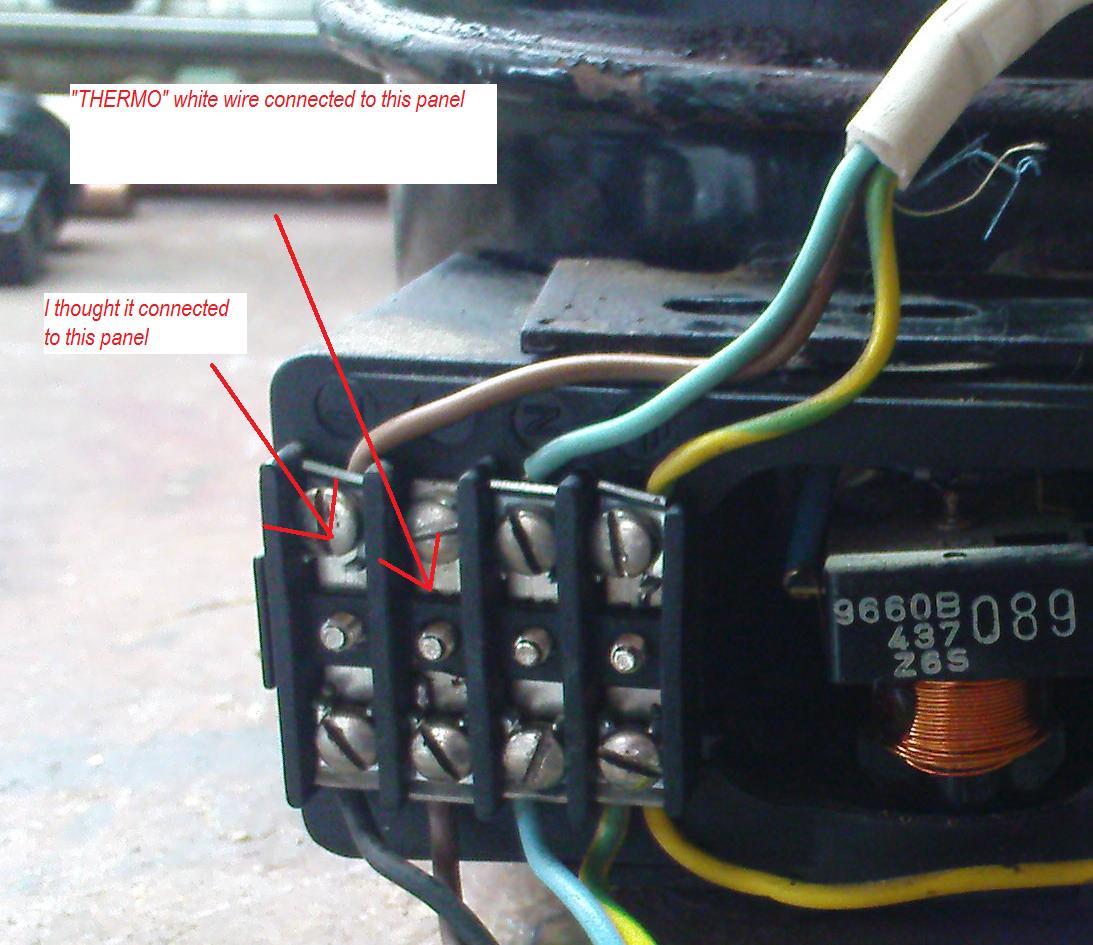

Of the top 3 wires, the yellow/green one on the right goes to nothing. The wire in the middle (blue) goes straight to the starter and the wire on the far left (brown) goes to the thermostat then the starter.
So, POLAND, the yellow/green wire I attach to ground, blue is neutral and brown is positive?

well that's not a diagram, is it ?? don't get me wrong but it's damn hard to tell you the right answer if there is so little info provided... you might try to hook it up or post more pics
yes
yeah that's what it seems..Of the top 3 wires, the yellow/green one on the right goes to nothing. The wire in the middle (blue) goes straight to the starter and the wire on the far left (brown) goes to the thermostat then the starter

This is what it looks like, I hooked it up like this and nothing happens when the power is switched on. Not surprising, the fridge was being thrown away for free...

nahh it doesn't have to be broken.. either it is wiring or one the relays might be broken
anyway.. about that thermostat thing... it's something different that what you think it is
http://en.wikipedia.org/wiki/Thermostat
there was a thermostat on a fridge - that's why there are two cables.. one of them led to the thermostat and it closed the circuit (starting the fridge comp. ) when a given temperature was reached
the thing that you've marked as 'thermo' is an...
http://en.wikipedia.org/wiki/Relay#Over ... tion_relay
there is a dark blue wire in '03DSC00413.JPG' what is it connected to ?? (uhmm I know it is connected directly to the fridge compressor and that it is meutral but according to that diagram it joins the starting relay with that 'thermo' thingy

HAHAH IT WORKS!
Ah right I see about the thermostat haha, anyway it's the round thing shown in that picture you mentioned.
The dark blue wire connects to the "thermo" thingy, which has a white wire which connects to the LOWER brown wire seen in 0202DSC00411.JPG.
Problem was that I had the UPPER brown wire connected to where it is seen in 0202DSC00411.JPG...which isn't connected to the thermo thingy (note, difference between upper and lower brown wire). In the tight space of the small box I didn't notice that the white wire coming from the thermo thingy was connected to the vacant spot between UPPER wires brown and blue. So all I did was swap the UPPER brown wire to the spot next to the UPPER blue wire (the spot which is vacant in 0202DSC00411.JPG) and it works
edit: picture to explain in simple terms what I just said
Thanks for your patience POLAND

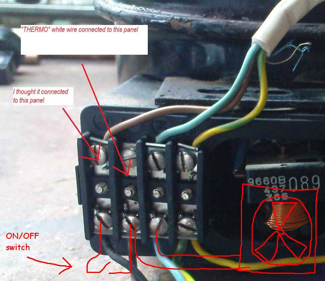

- POLAND_SPUD
- Posts: 5402

I added a simple diagram... it shows where you can put an on/off switch and how to power a fan (assuming you want to add it)
you can get some fans similar to the ones used on CPUs but they run on AC 220V.... of course a fan is not required but it is useful if you use the compressor a lot
try to build your setup in a way that would allow you to rebuild it or mod easily... just in case you compressor breaks down or if you want to add more compressors to it...
ohh btw... do you plan to add an air reservoir ??

@poland spud: For those of us that don't know(aka me) what is the fan good for/ why does that part with the copper wire need the cooling more so than other parts?
- POLAND_SPUD
- Posts: 5402
lol sorry... I forgot to mention that it shows wiring only... this doesn't mean that the part needs cooling... a fan should be attached in a place where it that would cool the compressor casing most effectively
