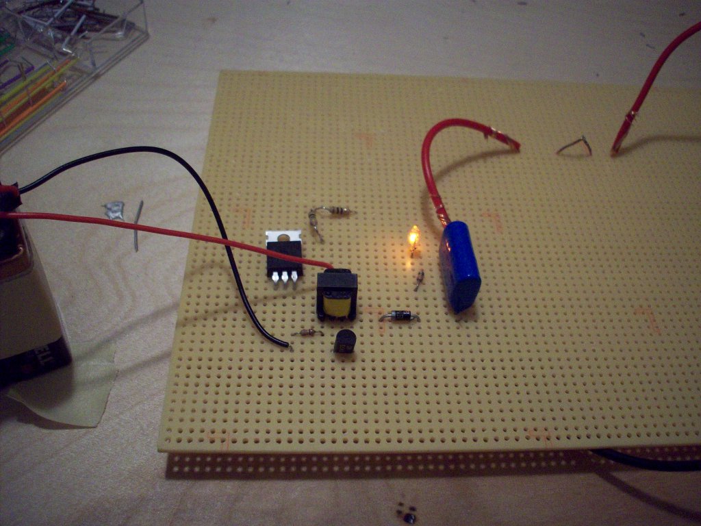

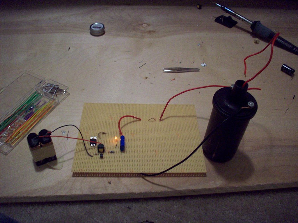

Well, I made my first prototype tonight.
I tried the neon bulbs, but I guess I couldn't get a hold of the right ones, because with FOUR of these in series, they would be powered with no problems just from the rectified DC from the transformer.
So, in a ditch effort to make it work, I rigged up a spark gap for the capacitor, with the electrodes simply being solder-coated leads of wire.
When I FINALLY got the spark gapped correctly, it sparked at a rate of roughly one spark per second (this was with a 1 uF capacitor).
Here's a picture below. This was the first serious circuit I've put together, by the way...
Simply a close up. The fiddly spark gap MUST go, though.
The charging circuit has basically just been transferred over to the perfboard. However, it runs off a variable voltage regulator hooked up to an 18v battery pack (final configuration will be like this).

I did say about those manual spark gaps :P
Seems to be an extra transistor/thyristor/3pinnedwossit along with two extra resistors on the board?
Shouldn't need more than the transformer + resistor + transistor + diode with optional extra resistor + led for charging status.

Actually you might be using a different transformer which would make more sense. The small 5 pin green/blue transformers primarily from Kodak boards are the ones I use. Some Japanese brands and generic types for sale in say wedding bulk packs use up to 7 pin transformers.

There's a voltage regulator and three extra resistors (to adjust the voltage regulator... didn't have a 20 ohm resistor so I combined a couple...). This fits more closely the final circuit (where two 9 volts run the ignition and fan).
I might actually just try using an SCR to switch the current to the coil. With a big enough resistor it should supply the gate current at the full charge voltage...
If not, I could just make it a "one shot" igniter. :roll:
EDIT: My transformer has the same configuration as yours (5 leads, each to the same type of internal coil), but the pinout is just different. I check the pinout and mark it down before removing the transformer from the PCB.
