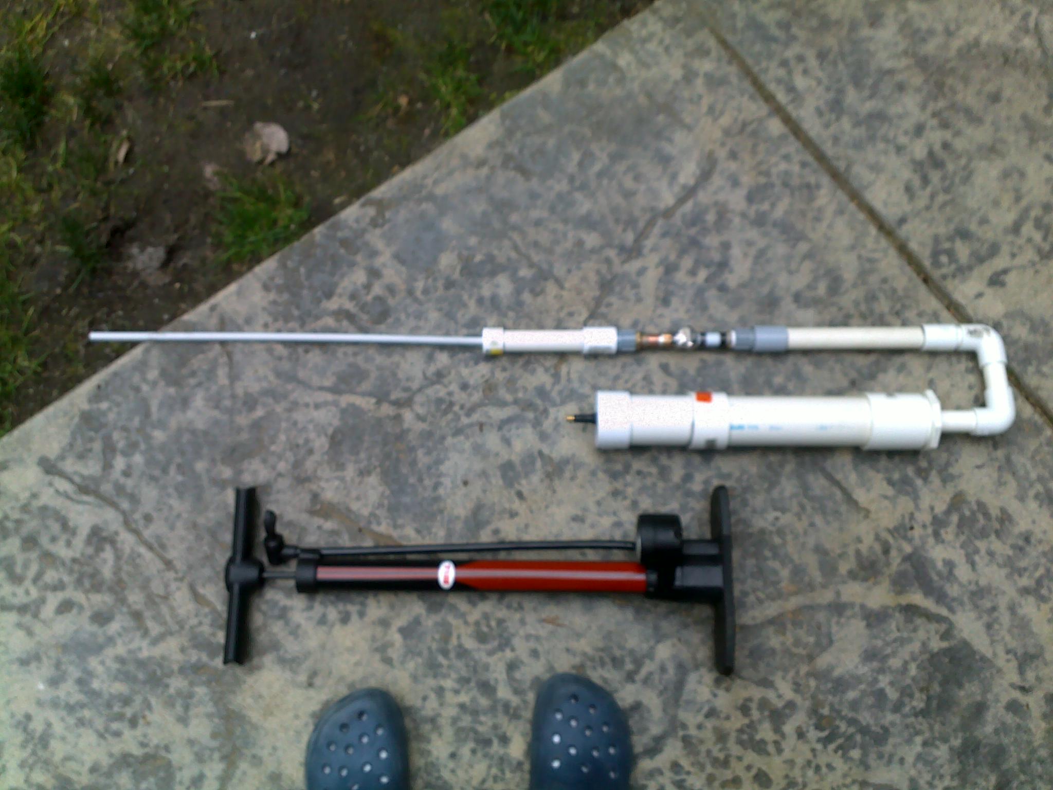

wth minei run it at 40 to 80 psi (depends on what im shootingat) and the spread is a result of you movingthe gun slightly between each bb comming out. rememberi ts not like a shotgun where all the pellets come out at the same time, each bb leaves the barrel seperatly so spread is a result of a combonation of the following: you moving the gun ever so slightly, inconsistancy in the ammunition, each bb is also fired at a slightly different pressure so the trajectory is affected, and also barrel movement ifyou barrel is not firmly attached. look up 2nd 6mm vortex and watch the video of mine and a pic which might give yu some help, sorry about all the spelling errors, im doing this from my ps3 andi have a tiny keyboard. edit: im guessing if your barrel end vortex cap was shaped like a cone you would have a much higher rate of fire because the bbs would hve a greater chanceof entering the barrel at a higher velocity. just a theory. :D

for my barrel i just used some connector rod for toilets (really cheap :D) and a ¼ inch BV
