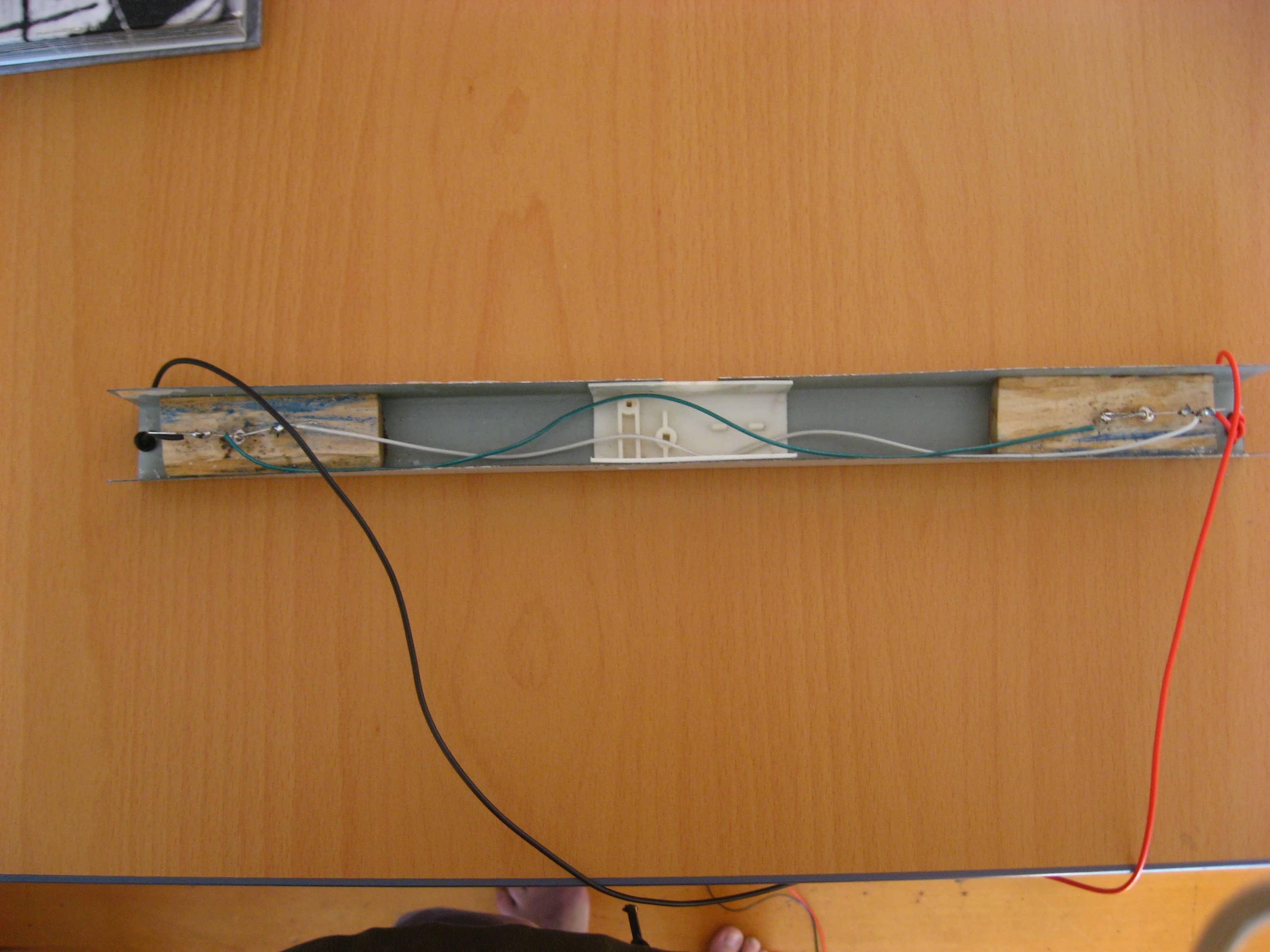

Phototransistor Chronograph:
Big thanks to Jimmy101 for his help.
I tried this method mainly because I thought it would be interesting and a fun project, it was. For this you'll need two phototransistors. I picked the only clear phototransistors available at my local JayCar store. You'll also need something to mount these to that shields most of the phototransistor from light and keeps them at a fixed distance apart. Jimmy101's website page above was very helpful, so be sure to check it out. My phototransistors are mounted in wood with only the top of them open to the light. They are then mounted in a thin metal rail which is fixed to a flat piece of wood to stop it from being blown away. My circuit is wired in parallel with no resistors and connected to a stereo channel 3.5mm audio plug. I also used Audacity to record with.
I found this method slightly better for my purposes as I am limited in shooting space and this mehtod only requires that the projectile leaves the barrel, no target is needed, only something to stop the projectile. It will also give you a higher velocity reading because you can measure the muzzle velocity instead of the velocity from a distance. I have a very basic knowledge of electronics, yet I was able to construct this so don't be put off if it sounds difficult.
This chronograph is also very cheap to construct ($5) and easy to build. Only problems I've had with it is the lighting, it wont work under fluorescent lights as they turn on and off rapidly which will interfere with the signal. Some people use LEDs to enhance the spike generated when the phototransistor is blocked from light, I found this a bit difficult so instead I just use a cheap 500w flood lamp which does the job nicely. Though the chronograph will work great (large, clear spikes) outside as long as it isn't too dark or cloudy. I found it even worked in overcast weather fine.

Phototransistor chronograph

nice work mate and a good write up. I am liking the second method alot more, seems to be more accurate...
It should work in any lighting, as long as there is some light... All you need is constant light, (so dont use this next to a strobe, remote controls fluro or energy saving lamps... Dont they use PWM to control brightness?? )when you use more light it will just make the spikes bigger and easier to see.

Looks good. The phototransistors I've seen all respond well over the visible spectrum (the ones labeled IR phototransistors). Haven't actually used them with AC lights (worklamps, etc.), but I'd think that a worklamp would oscillate as well (though I may be wrong) at 60hz.
But if it's working it's working. Good job!
Wed May 19, 2010 5:27 am
Yup you're right, there is some noise but nothing compared to a fluorescent. Though the muzzle blast seems to be defeating what the light is fixing because the mist interferes with the peak/spike, so I need to sort out some muzzle brake thing. I've removed the "stock" on the V.A.L which should reduce some of it.
Those would be the darker coloured ones? I read somewhere they only work well with IR and not so well with other light, I'm probably wrong.
