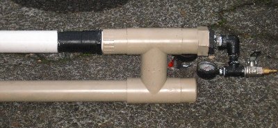

Well here's the cannon after a new upgrade/downgrade as i've removed the stock. Paintjob has suffered a bit and I just realised it has almost been two years since I posted the cannon.

Was there a noticeable loss of power from reducing the chamber? I like the look, much cleaner looking. Easier to service the piston if needed. I'm assuming the barrel will need to be shortened. I am building two more for my friends, I think I will make one with this modified design.
Tue May 25, 2010 5:04 pm
Not at all, my chamber was far too large before.
Never, ever should you shorten a barrel unless you have to. More often than not, it is increasing barrel length and not chamber volume which gives you better performance.
