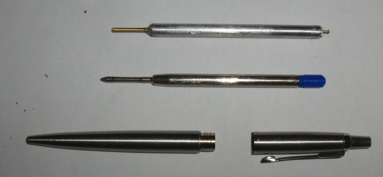

Here's my latest pengun, it's designed to fit into an existing pen without modifying the casing. In this regard external dimensions are very similar to the ballpoint refill it will replace.
As I was constrained to 6mm maximum external diameter, I couldn't use an ordinary schrader valve. Instead of making my own, I figured it would be easier to take a schrader core and epoxy it directly into the chamber. Fits nicely, but now the issue is how to fill it. I've made a ghetto fill station which is basically a sealed tube in which the whole firing unit fits, we'll see how well it works after curing.

hah that looks cool! i hav an idea for filling, the end of the chamber where is the shrader core, put the gun into a drill ja file it a little bit, then tap same screws trhat schrader has and fill it with normall shock pump?

That won't work, to have threads that match a schrader it won't fit in the pen casing. If I did I just would have stuck a schrader in there as usual :P

what about a compression fitting for filling?

Why not thread the outside of the casing? If it is 6mm then it should fit pretty good into a schrader hose.
