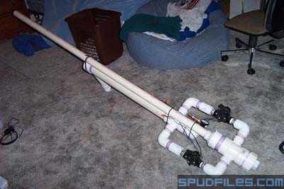

Every source I could find on the Internet was telling me how much more powerful than a combustion gun a pneumatic gun can be. I have an air compressor, so I figured I'd give it a try. I only paid something like $20 for the CSVR-1 (and most of that was for the sparker). I think I figured I put over $100 into the PSVR-2. (That includes the two valves I ordered online that were never charged to my credit card. I love free stuff.) PSVR-2 was also immensely complex for only my second potato gun and my first pneumatic. However, I managed pretty well, and the only problem I had was a leak between a threaded PVC fitting and a metal nipple. I haven't been able to fix the leak completely, but it's now such a small leak that it's not a problem.
Here it is sitting on the floor of my room. My room contains a high level of entropy.

- The thing I'm most proud of on this gun is the breech loading chamber. When I thought up the idea for how to do it, I'd never seen it done anywhere else. Even now, I've only seen it done on one combustion gun. It works, but it has its faults.
- PSVR-2_vertical.jpg (15.23 KiB) Viewed 13348 times
- At the time I built this monster, the only way I knew of to trigger the valves was to rig up an electrical system. Mounted in the handle in the front is a toggle switch (safety), a momentary pushbutton (trigger), and inside are three 9 volt batteries wired in series to make 27 volts. The valves are designed to run on 24 volts.
This gun is currently out of commission, because I am converting the triggering system from electrical to pneumatic. This will not only simplify it (no need to worry about dead batteries), but it should boost performance.
Specs
barrel diameter: 1.5"
barrel length: ~84" (7')
chamber diameter: 3"
chamber length: ~38"
C:B ratio: ~2.07:1
special features: two 1" electronically triggered sprinkler valves, special breech loading chamber - PSVR-2_breech.jpg (12.59 KiB) Viewed 13348 times

I like the overall look of it but I think that the breech style loading through the cross on the back constricks the air flow like a mofo
NEGATIVE
Are those sprinklers Pnuematicaly operated, if not you should make them. lol
I like how the gun looks, but the breech does constrict flow alot.
How do you shoot that monster, Bipod, ground, HOlding?

it looks like it's shoulder fired cool idea how bad is it for kick do you guys think it would be also does and one thuink that a cannon of that size is just a little impractical to be shoulder fired or is it just me realy nice looking cannon thouch i have to say
