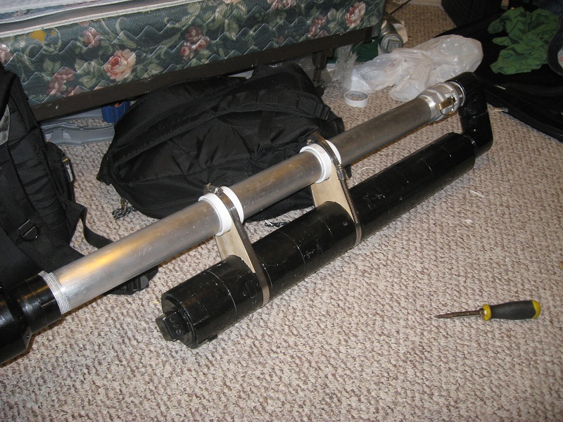

This is combustion cannon that I did a lot of work on earlier this year, but never got around to finishing. I will probably complete it once my birthday comes around, since I will be getting some extra money.
The chamber is 3"dia x 30"length DWV, but it's layered in couplings, so I figure it should be safe.

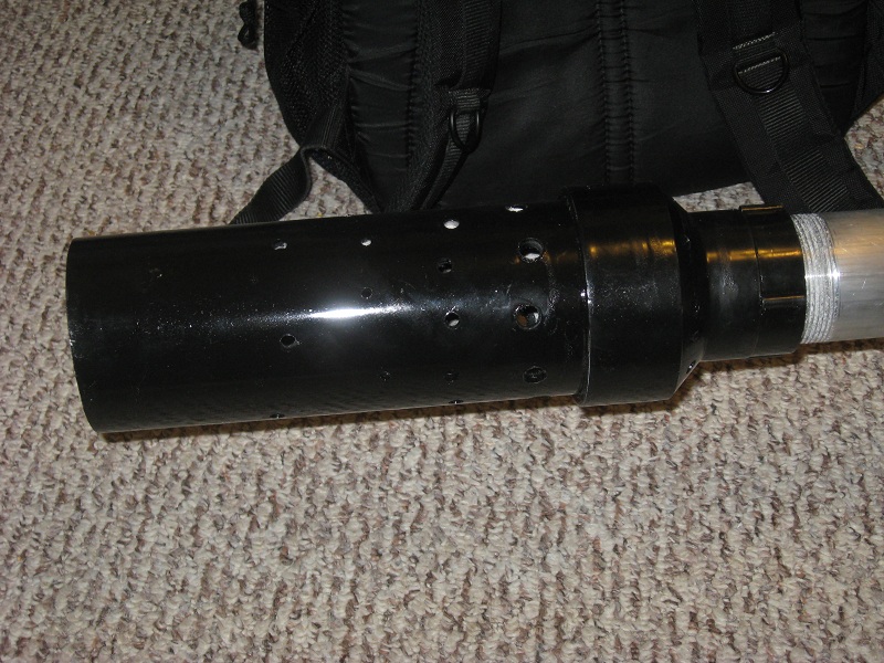

The barrel is 3 feet of 2" 6061-T6 aluminum, and I plan to polish it once the cannon is complete. The suppressor at the front was simply made with a 2"x3" bell reducer, and a length of 3" pipe, both painted black, and with several holes drilled in it. I'm not sure if it will have any effect, but it at least looks awesome.

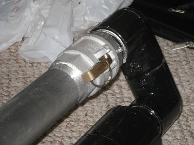

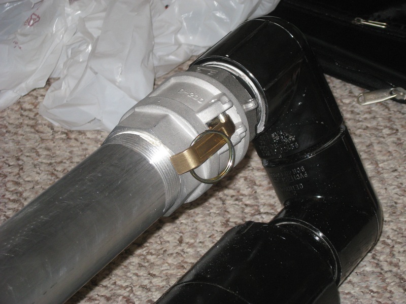

The breech loader is an aluminum 2" camlock. The barrel slides back in its housing to allow breech loading.

For a combustion a shorter larger diameter chamber is often better as there is less surface area for cooling for the same volume. Combustion completes faster in a short chamber for faster pressure rise.
Overall, I like it. The double layer is not needed as black ABS cellular core pipe has proven to work well in basic combustions.

Actually, it's not black ABS, it's just painted PVC. I wanted to go with a larger diameter chamber, but my local hardware store did not carry any kind of pipe over 3" that I felt safe using. Once it's complete, I may make some burst disks and try it as a 1x hybrid.
Thats looking really nice so far, I like the layering of the chamber, I've done it before in my PVC hybrid (see my sig) it gives a really solid feeling chamber, I had to dismantle it recently for space and out of interest I chopped the chamber in half, the solvent welds had taken perfectly and it looked like a single piece of tube with a 1/2" wall
From the picture it looks like your ali barrel is threaded, can you buy that or did you do it youself?
My uncle works at Wisconsin Metal Fab, so he got it threaded for me, however, you can get threaded Al pipe from McMaster as well. By the way, nice hybrid. I've never seen that one before.From the picture it looks like your ali barrel is threaded, can you buy that or did you do it youself?

looks nice. as tech said, a smaller length chamber may improve performance.
Also, try using a 1-5 layers of aluminum foil on the cam lock, as a burst disk, just to help it build some pressure before it actually gets to the projectile.
it seems silly to use aluminum for the barrel, and settle for DWV for a chamber.... double layered or not, you best hope its not cellular core.
Im my opinion, DWV is retarded for use in any cannon.... its not like pressure rated pipe is that much more expensive... at least, not in the USA

The reason I didn't use DWV is not a cost issue. MY local store did not carry pressure rated pipe over 2". As for the aluminum barrel, I just had it laying around from another project that I could not complete due to cost, so I used it for the barrel.

@bighead, the barrel already slides, those are repair couplings. It is just like the old breech load on my golf ball cannon Superna! Great design for a breech load...
