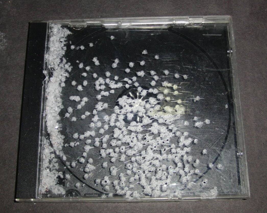

Here, have some clear plastic carnage :)
It's not *that* powerful, in that most shots didn't penetrate the casing, where they did it was due to the "jackhammer effect", but given the size of the ammunition, still quite impressive.
