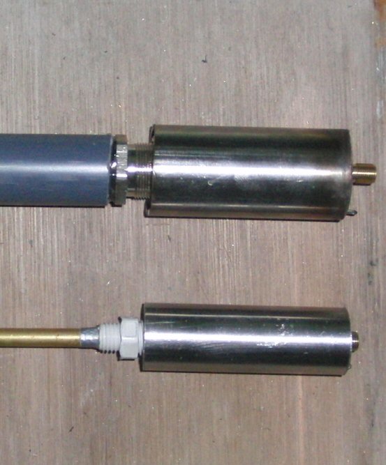

Following the success of this project, I've decided to ramp things up a little :D still a "mini" by this forum's standards but with a 3/4" barrel and a wider chamber made of 2mm wall thickness 316 stainless, with the threaded fitting from an ATEX electrical connector.
As the weather's gotten colder it will be given a good baking today, testing later :) here it is compared to the subject of this thread for scale:
Wed Oct 27, 2010 10:22 pm
Who knows, maybe by christmas you'll have a hybrid that's bigger than my hybrid's fueling meter :D
Kidding aside, I'm glag to see you've ramped things up a little. Bigger may not always be better, but it sure is more fun. Do you literally bake your epoxy creations by the way? Just wondering what your method was and if it's better than conventional methods of leaving it in the garage over night :wink:
Wed Oct 27, 2010 10:36 pm
MrCrowley wrote:Who knows, maybe by christmas you'll have a hybrid that's bigger than my hybrid's fueling meter :D
Who knows, outback boy :P :D
Most epoxies cure faster when at higher temperatures, in Summer I can leave stuff out in the sun and it will be done in 12 hours whereas in Winter sometimes it doesn't cure after 24 hours. At this time of year I find chucking curing parts into one of the lab ovens at 50-60°C means that they're ready for testing by the time I get home :)
