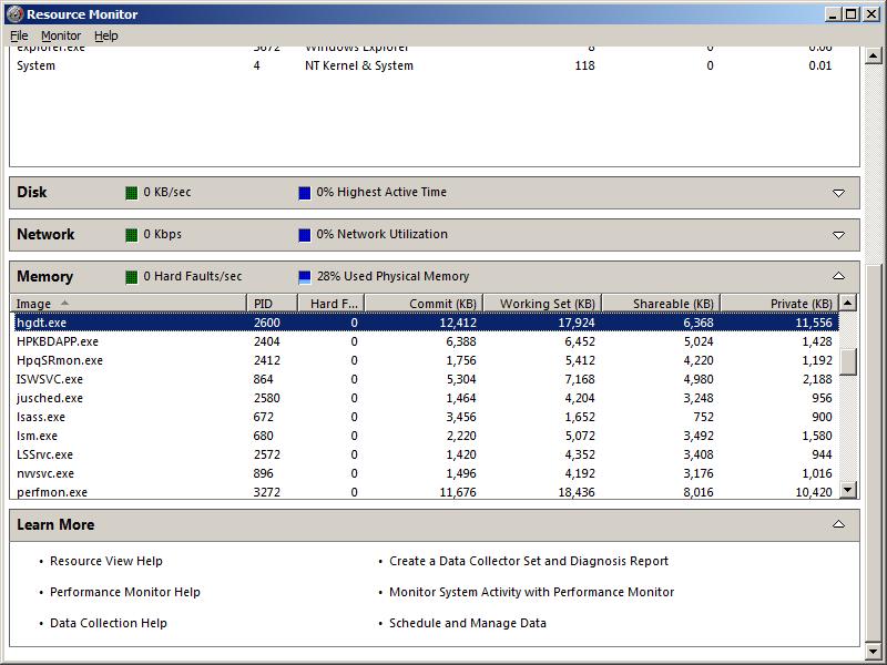

EDIT AGAIN: Looked at the Performance Monitor during a lockup. The Memory Allocation climbed to nearly twice its original size as depicted in the pic. I also had stopped or shutdown every program I didn't need running when I ran it.
EDIT: Just downloaded from D_Hall's site. Unzipped to its own directory. Made 3 calculations, changing only the barrel length, no problem. On the 4th attempt, it locked up again (Not Responding), but this time the CPU didn't seem to be overworking. Usually the fan immediately goes to high speed as the CPU starts to work harder. This was what I got with the previous install, eventually with the CPU starting to go nuts. This was version 5.4, although your site showed a screenshot of a version 5.7. Is this in the making??
