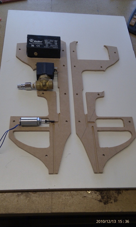

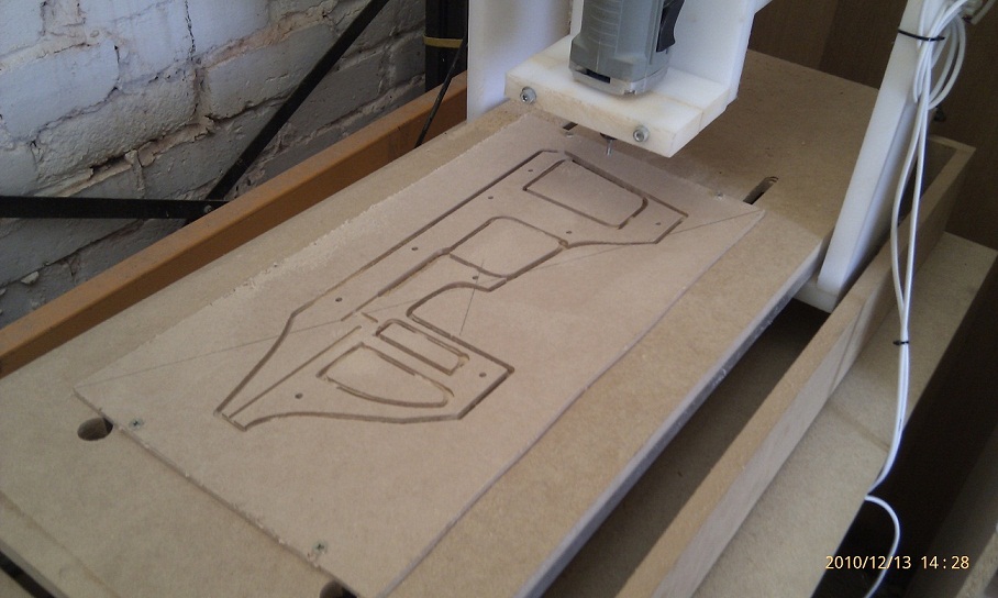

Making progress
The prototype for the receiver is taking shape, just using MDF for now, the final job will be a series of mm plates of black HDPE. The laminated idea is simply so I dont have to bore and align magazine feeds and barrel housing for the upper receiver; I just make them in mirror halves then bolt it all together. Makes it easier for upgrades and maintenance as well.
The next step is to make two more half shells, this time only pocketed for the equipment rather than cut all the way through.
Cheers
Making progress
Cheers
Looking cool man, i hope it all works out for you !!

Man, I wish I had a CNC Router. This is going to look really slick.
