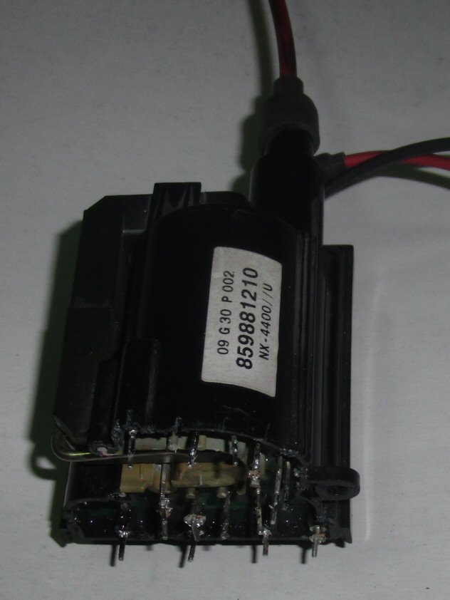

So, after a bit of work with a hacksaw, pair of pliers and a soldering iron
finally got one of the flybacks off.
What's the easiest way to hook them up, possibly with parts I can find on the CRT circuit board itself? The articles I've skimmed through so far are a little confusing.

Flyback testing...
The primary coils I found were all on one side. You can check this with a continuity meter or if you don't have one, a battery and a bulb can also check for continuity.
There's more than one coil on the transformer you see, and terminals which are linked together are on the same coil.
You can see the Yellow leads which I had on one winding as the primary winding and the Green leads on another winding for feedback. There's a bit of fiddling about needed to find the best sets of terminals to use for each.
The black lead was on the terminal the HV wire (thickest wire coming off the top) most liked to arc to. There's several it will arc to easily but there's a favourite.

So, take out transistors and resistors from the CRT board (I think they are transistors, vague recollections of my physics teacher referring to "three legged beasts"Hotwired wrote:To be honest most transistors will work if they're the right type and not hugely underspec, details such as the best one for it can be sorted once you have a working circuit.
I bought a lucky dip bag of transistors and almost all worked, to various degrees.
I actually have a continuity meter, is this what I need to do?The primary coils I found were all on one side. You can check this with a continuity meter or if you don't have one, a battery and a bulb can also check for continuity.

No harm in it at any rate except to patience if they don't work. Tricky bit with transistors you don't know is which legs are which and if they're npn or pnp types. They have codes on them you can look up though.jackssmirkingrevenge wrote:So, take out transistors and resistors from the CRT board (I think they are transistors, vague recollections of my physics teacher referring to "three legged beasts") and have a play
Yes, that's a more organised way of going about it, I just checked which terminals linked up personally and then applied voltage until the HV line gave off the best arc.jackssmirkingrevenge wrote:I actually have a continuity meter, is this what I need to do?
