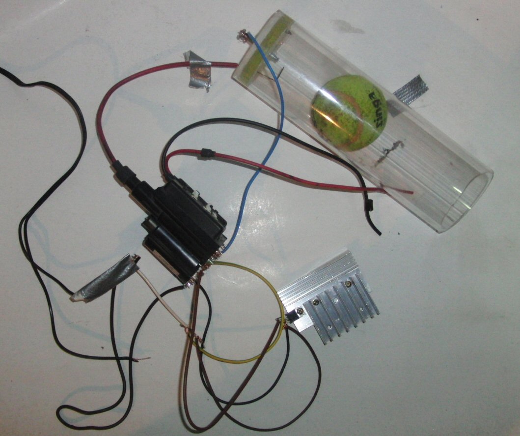

Tue Jan 25, 2011 4:51 pm
haha win!
Doesn't seem as powerful as Hotwired's (I'm using a 12v 1 amp supply), but looks good enough :) bit late for testing a high mix hybrid but I gave the tennis ball launcher a whirl and it worked beautifully.
Thanks to everyone who put up with my cluelessness :oops:
Here's the setup, twisted wires all the way :roll:

Tue Jan 25, 2011 6:21 pm
Hotwired wrote:Ahar yours is working. Great stuff.
Thanks for the help :)
Hotwired wrote:And a reminder for me as to why I bought a large pack of crocodile clip test leads
Yep :roll:
Now that I have it working, I'll probably use JSR soldering (dab of araldite over twisted wires :D) to put it together more permanently, then put it in a container with a 12V CPU fan to keep things cool.
In the meantime, here it is in action as the ignition for the clear tennis ball combustion, *whooph* :D
