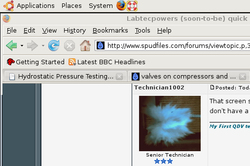

That screen shot isn't mine. I'm not using Windows. Need to ask the original poster..
I don't have a green start button.
On another machine I use Ubuntu Studio. Here is a screen capture of one of my machines.
No green start buttons for me.
Ubuntu; http://www.ubuntu.com/
Ubuntu Studio http://ubuntustudio.org/
The screen shot is from this thread;
http://www.spudfiles.com/forums/can-you ... 19369.html
