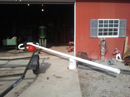

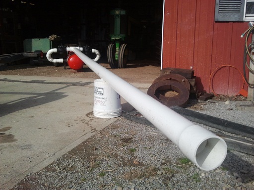

I did a quick mock up of the cannon. The trailer to which it is going to be mounted is in one of the pictures on the left. The "sweeps" are not permanent.

looking good, but why didn't you put the ports on the same side of the tank. would have taken out 1 turn, still looks like it can do some dmg

Mon Mar 28, 2011 9:59 am
With the PVC barrel, you could do an in barrel chrony shot to optimize the length of the barrel.
That thing is a beast..

-_- wrote:why didn't you put the ports on the same side of the tank
I was worried about the integrity of the welds of the pipe to the chamber, so I put the whole pipe through so that any forces outward would negate each other, rather than having two nipples facing in the same direction that do not have any backing. The pipe is weight bearing.
And Technician1002:
I will have to trim the barrel at least 3 feet to get it to mount to the trailer without hitting the truck.. so barrel optimization will probably be one of the last steps.

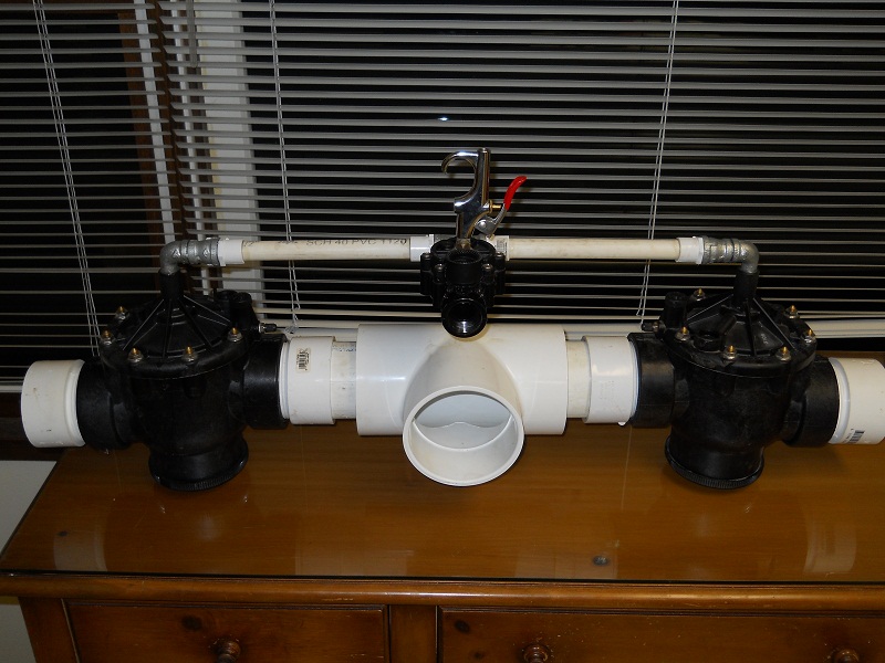

Here is the complete valve and trigger assembly.

Holy crap that's a monster.
