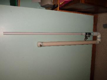

This is my first over-under style gun which all of the parts i got for it were free!except the sprinkler valve. I got all the parts from one of the workers at a reece plumbing store which i befriended and they where doing stock take so he gave me a few piece of pipe and fittings which they didnt want to bother about having to stock take on.I got 2.3meters of class 12 50mm pipe and alot fo fittings and all the 50mm fittings for free.FREE!!!
Its pritty simple and shoots carrots out of sight,which is pritty cool and i also plan on getting a 50mm barrel aswell i still have alot of the 50mm pipe left over from the chamber so all i need is reducers.
Tell me what you think and anything i could add to it.Thanks for your time.
The whole cannon and i am going to make a suport from the chamber to the barrel.

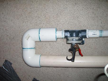

This is the guts of the cannon.

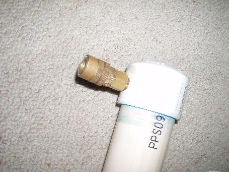

This is my fill in point.Its a female compressor connection which i use with a ball valve to fill it.

Dude! what is up with you and carrots?Sweet cannon but it really needs a paint job.What is that paper stuff on the sprinkler valve?

Nice gun, but why do you need a ball valve to fill the female disconnect, just pull out the male when it's done filling.
I'm going to put a ball valve and a male quick disconnect on one of my guns...

The reason have a ball valve is because on my air compressor i use 2 female conections and i have 2 male connections with a 1/4 ball valve in the middle so i can choose when i want to fill it not just connect and fill.

cool. not the best looking cannon on the market but still. how far it shoot?

Well i shot a large marble from my house to a beer brewry that is about one and a half city blocks away so i guess...400 meters or more.

hey you live in Aussie right? so where do you get your sprinkler/solenoid valves?

we get our solenoid valves from bunnings wearhouse

bunnings sells them from 16-30 dollars, but make sure you get one with "OUT" a guide rod because then they are so much easeyer to modd. the guide rod is a black turning thing and it controls the flow rate so dont get one of thos

In Bunnings i have only ever seen valves with guide rods they all come standard with it even the ones with out the flow control so what you do is mod the valve the usual way you would and take out the guide rod then fill the hole were the guid rod was wiht epoxy then wait till it is dried and heat a a needle in a flame till its red then poke a small hole through the epoxy,this acts and the equalisation hole thats how i have modded my valves with guide rods and the valve i got from Bunnings was $16 but i think they went up in price now they are about $20.
Sat Aug 26, 2006 9:34 pm
how big does the eq hole need to be?

As small as possible
