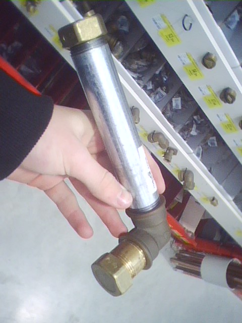

So I went to the hardware place today and checked out the plumbing section. After looking at all the cool stuff I decided I better see if the have some appropriate bits for the gun. I didn't buy anything yet, just wanted to see if it would go together well first.
Parts in pic as follows:
End cap on silver pipe: the end of the magazine, this will have the plunger/spring to feed the ammo.
Silver length of pipe: The magazine, they either have this or some super long one, hopefully I can find a compromise.
Right angle joint: so I can fit the mag in the case.
Small joining length of pipe: pretty much the vortex cap, it just give it a smooth inside.
Other end cap: the cap part of the vortex cap, it is threaded right up to the end so the joining length of pipe screws in to make a smooth surface for the BBs to spin around on.
