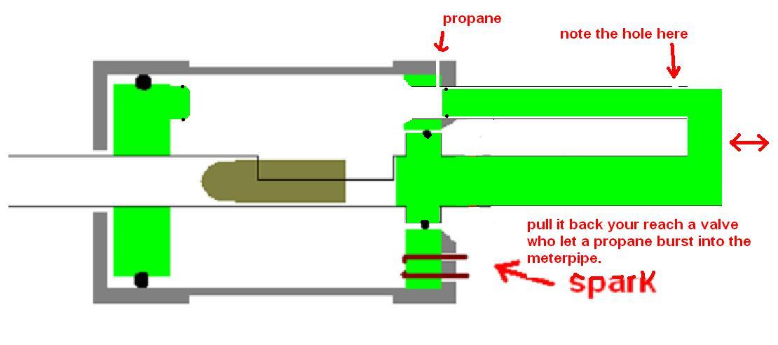

hi here a diagram of a working micro repeater. add magazine and push button fuel so the pump-action is easy to archive.
easy to build
by me it works with 8mm barrel and syringe fueling power is bad by the small barrel diameter but in 1inch size it will work fine.
i hope you get the diagram
green is epoxy and grey are pvc with two endcaps

jean- very nice layout. I like it a lot. I may do a similar variant sometime.
