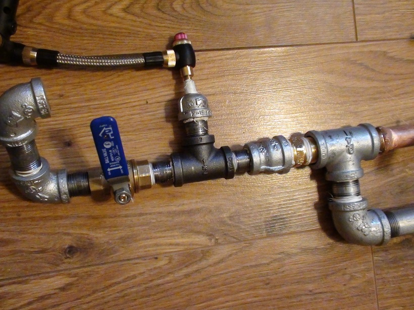

I found about Spudfiles.com about 2 weeks ago and i was wow, i can build nice high power air gun, so i decided to go with the piston valve design. I plan on transforming it in an hunting rifle, or totally replacing it with steel components and take it to 1000 PSI, or more with a home made HP pump. its .55 caliber, 40 inch barrel with barrel action breech loading. it shoots 4 inch 16 gram/ 246 grain nail thru 3 inches of solid wood from 15 yards, i didn't go past 300 PSI . I have a 400 PSI shock pump. The piston is made out of a screw with rubber sealing head, floating O rings and integrated some plastic washer for stability in the brass nipple, and rubber and foam bumper. ill put a scope on it some kind of stock. The air tank is a 12 inch galvanized steel pipe , and the volume is 150 ml, or cubic centimeters.
The piston has Teflon tape under the nuts, so the seal is perfect, this rifle will fire at 10 PSI, or 400 PSI. I get my scope soon,

anybody know the PSI rating for galvanized pipe and fittings, safe working pressure??????? what about brass is it weaker or stronger

pilot volume is kinda big, should put a spring so you can put it where the chamber is

That piston looks way to ghetto for 1000psi, the rated pressure for these pips is 150psi, but many have taken it way passed that. I would go buy stainless pipe and fittings only because they wont rust and eventually weaken the pipe.
