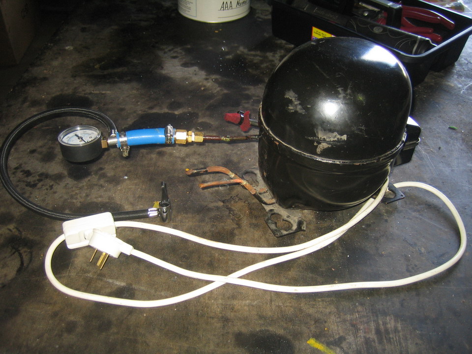

We got hold of an old fridge compressor and have played around with it a bit. The most we've taken it to is approx 160psi, next step is a bigger gauge and higher pressure testing.

Old fridge compressor (aka Wilson).  Pumps this chamber up 100psi every 5sec (approx)
