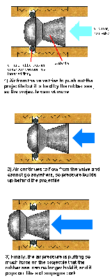

and for example on that gun, what does this mean : This gun utilises a screw in rubber washer compression fitting to adjust the amount of pressure required to burst a bb through the washer.
what does that mean and where is that located

I really must be in a Friday moodkillshot11 wrote:what does this mean : This gun utilises a screw in rubber washer compression fitting to adjust the amount of pressure required to burst a bb through the washer.
This should be enough explanation. Note that the more you compress the rubber washer, the more it protrudes into the barrel and the stronger it hold the projectile, meaning it will need more pressure to pop the projectile and you get a more powerful shot.

With the design jsr gave you, you will have to quickly release the trigger to refrain from wasting air. But if you just add something like this
then were talking
then were talking
