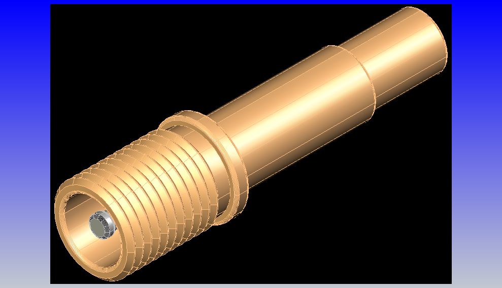

- Schrader Valve from TR413 Tire Stem
Mon Oct 26, 2009 11:29 am
Complete with "lathed" down body
Amazing detail as always, if only there was a way of modelling poured epoxy hehe
