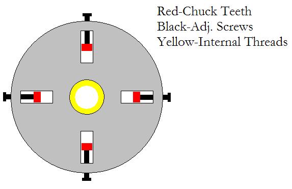

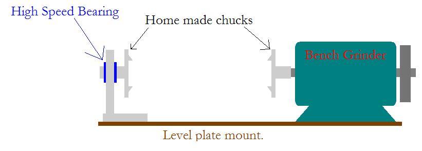

I thought about an idea for a homemade lathe attachment for a bench grinder. It's pretty much just threading the chuck onto the bench grinder and bolting the grinder to a very precisely cut mounting plate with the opposing chuck bolted down across from it.
I've yet to see anyone try this.

Tue Jul 26, 2011 2:03 am
wouldn't a bench grinder be too fast? maybe using a 90 degree twist belt from a pulley held in a bench or pedestal drill press. you'll have variable speed with the drill press and then you can also easily mount/remove the pulley( for other drilling operations.)
sure, eventually you'll bugger the bearings in the drill press from side load, but i'd rather chance that then slow spooling up speed of the grinder and also the risk of something spiting out at 2000 rpm. :idea:

jerome wrote:wouldn't a bench grinder be too fast? maybe using a 90 degree twist belt from a pulley held in a bench or pedestal drill press. you'll have variable speed with the drill press and then you can also easily mount/remove the pulley( for other drilling operations.)
That's understandable. Normally, lathes spin slower for harder materials but I guess you could throw in an CVT on a turn knob adjustment. That would give completely variable speeds. It would be expensive though and that kind of defeats the purpose.

Tue Jul 26, 2011 3:09 am
One important safety item. DO NOT leave any screws extending out of the chuck. They were known for eating clothing and what ever was contained inside the clothing. Recess the adjustment screws and have the jaws move on screws that don't extend out.

Tue Jul 26, 2011 3:22 am
:shock: Good note. I myself only wear t-shirts but I will definitely do that. Don't want to lose a limb.

Mr.Tallahassee wrote:It's pretty much just threading the chuck onto the bench grinder and bolting the grinder to a very precisely cut mounting plate with the opposing chuck bolted down across from it.
I think mounting the motor and a "tail stock" is the easiest part of the project. What about a tool post, cross feed and screws? Why have bearings in the tail stock? Tail stocks are normally dead.

Tue Jul 26, 2011 3:31 pm
Actually, they aren't "dead". They normally have small rollers on high speed bearings that run along the surface of the work material but this works essentially the same. I didn't include the tool rest but it just bolts along the edge of the mounting plate and will be adjustable. This was really meant for just machining pistons and o-ring grooves, nothing complicated. I probably should also do a diagram of the mount.

pipeboyswe wrote:
Or more than a limb....
That needs to be made into a "motivational poster" for shop safety.
Anyway, thanks for mentioning the recessed adjustment screws. I was sketching up chuck ideas myself just the other day and would never have thought of that.

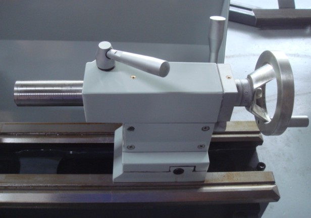

Wed Jul 27, 2011 12:52 pm
Mr.Tallahassee wrote:Actually, they aren't "dead". They normally have small rollers on high speed bearings that run along the surface of the work material .......
Below is a pic of a typical tailstock on a manual lathe. It looks exactly like the tailstock on my lathe. I could be wrong but..............it sure looks dead to me. :lol:

Wed Jul 27, 2011 4:00 pm
The live tailstocks are becoming increasingly more common so why not upgrade?
Traditionally, a hard dead center is used together with suitable lubricant in the tailstock to support the workpiece. In modern practice the dead center is frequently replaced by a live center, as it turns freely with the workpiece — usually on ball bearings — reducing the frictional heat, especially important at high speeds. -Wikipedia

Wed Jul 27, 2011 4:34 pm
Mr.Tallahassee wrote:. In modern practice the dead center is frequently replaced by a live center..........
Correct but....... You are confusing the terms "Center" with "Tailstock". A Tailstock and Center are not the same thing. Tailstocks are DEAD........otherwise they couldn't be used for drilling. Whatever tool the operator chooses to insert into the tailstock (i.e. Live Center, Dead Center, Drill Chuck, etc.) is another matter but, the Tailstock does not turn ergo.....it's dead.
