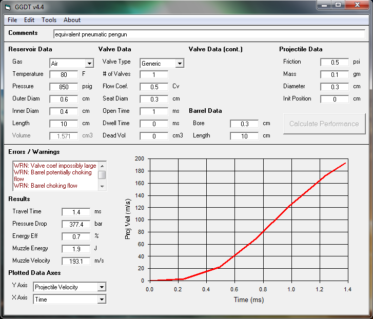

Giving this a bit of thought again for a pen gun cartridge for starters, looks like it has reasonably good prospects, especially compared to the equivalent HPA pen gun.
