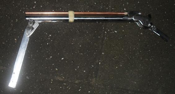

More work done...
I changed the factorymade swingarm to a homemade one...
Longer stroke and much stronger.
I now get about 1 bar per stroke. ( compressed volume equals chamber)
So I'm getting her up to pressure fast!
Also welded on the frame for the handle.
Both that and the lever will have a wooden cover.
Oh,...and I shortened it A LOT!
This is now officially project Sawn-off "the Dead"
When it's done I got an alround zombie stopper...
I could also take of the lever and put a 12 gram adapter in..
I already tried it and it fits right in.
Half an hours work to make the plug for it...
That means it could be shorter yet more powerful..hmm..
Maybe later...I like the free pressure.
LAST PICTURE IS DONE IN MS PAINT!It's not real ( yet)
Just playing with the idea of using a 12 gram adapter so it could be even shorter.

Ohh man I really love the last pic, amazing ! I'm making a pump like yours too, I used a 1.5 dia piston 20 cm long and the dead space is about 0.5 cm, cubic what's the max pressure I may get?
CpTn_lAw wrote: "yay, me wanna make big multishot pnoob with 1000 psi foot pump compressor using diamond as main material. Do you think wet bread make good sealant? "
- POLAND_SPUD
- Posts: 5402
yup... that was to be expected - the longer the stroke the less significant the deadspace becomesI now get about 1 bar per stroke
probably most of the stroke on the previous pump got wasted in the deadspace
Of course you could get even better results with even longer stroke... you could probably go for real overkill and build a gun where the stock would split in half so that you could use both parts of it as the pump handle
naaaah go for 88g cartridgesJust playing with the idea of using a 12 gram adapter
It requires greater co 2capacity to be an effective
zombie stopper
