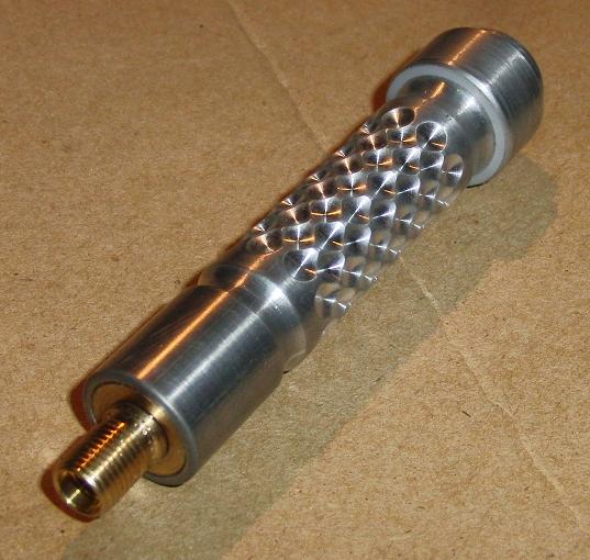

I've been thinking about the surface finish for the handle that I will use with jake's blade, I think a denser take on the "dimply" concept just might work...

Lots of swarf later, coming on pretty nicely even if I say so myself :D

Holy crap that looks amazing!!

woa thats incredibly nice!!!!

Cheers guys, really happy with how this is coming along :) working on the firing mechanism, I've gone for a 5 point detent which should hopefully spread the load and make it a bit easier to trigger, as well as reducing wear on the "tail" section.

Labtecpower wrote:Must have taken quite some time I guess? :roll:
99 individual ball mill strokes, didn't take that long to be honest, the rotary table makes it easy - you just have to maintain your concentration because one wrong measurement and you can bin it - amazingly I got it right first time, though admittedly I did give it a go on the old knife body first.

Does it give a lot of extra grip?

Labtecpower wrote:Does it give a lot of extra grip?
You'll be amazed...
Handle done, all I need to do is to make the "tail" for the blade :)
