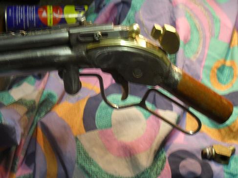

After a weak...I mean week of sickleave...I was urging to get back into the build..
Hands and wrists ache a bit but that didn't stop me...
Welded and shaped the front barrel support...
Changed/adapted the hammer...looks way better...
welded up some internal supports for the action, as it was putting some strain on the bolt by skewing.
Worked wonders..
Replaced the nut on the back of the bolt for one that pleases the eye a bit more...
I tried to fit a wooden handle to the existing frame...but ...I wasn't satisfied with the result.
I want a clean joint between the two materials...so I went to work..
Check out the pics.
I'm thinking about leaving all the " battlescars" from the welds...I think it adds character and gives the impression that it's way old.
The lows I mean.The highs will be filed smooth.

Oh my friggin god stop being so awesome, that thing is pure kick ass. Most innovative and creative pneumatic that the files have ever come by.

Would you believe I use the focus function?I would if I could actually see anything...
Never knew about it's existance before MrCrowley's bad batteries excuse though...
It might be so fuzzy 'cause I was standing to close to it...hmm...
I have to resize the pics anyway so I might try taking some photo's from a little further away and then enlarge the section I want to show...
The brass part is a combination of a couple of fittings and a lead ball...Simply BEAUTIFUL How did you make the brass part? mill it? The hammer looks kinda bunky
Not really looking like that anymore though...
That's what angle grinders are for see.
The main part mostly had that shape though.
It's bulky because it needs to pack the same wallop as the steel hammer...wich was both bulky and ugly..

more progress:
Tried to get better pics but this is the best I can do, even with additional lighting..
You'll see what I mean by a " clean joint" between the steel and the wood.
This would have been impossible with the prototype handleframe.
I also took a side by side of the hammer and a similar fitting I used to make it.
Bottom was filled by a plug, then cut and tapped to m6 to fit the steel part of the hammer.
It used to be a 1/4" fitting...
Anyway.
you can also see the right side wich is a little less clean.
Those are the battlescars I referred to.
Laquer is still drying.Just applied it.
