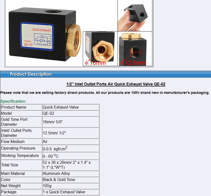

The items needed are illustrated below.
QEV disassembly:
Note the sticker describing the three ports:
"P" denotes the pilot port, where the slide valve should be attached. Your air supply/main chamber should then be attached to the other end of the slide valve. In this case I hooked it up directly to my compressor. This port is compatible with 1/4" BSP.
"A" is where the firing chamber should be attached. For each shot, all the air that is in this chamber will be emptied. In this case I made a small chamber from a section of PVC pipe with epoxy endcaps, with a 1/4" socket screwed into one end to attach to the QEV. This port is compatible with 1/4" BSP.
"R" is where the barrel or magazine should be attached. This port is compatible with 3/8" BSP.
A note on thread sizes:
The threads are weirdly described on eBay but in my experience so far it's safe to assume that if the threads have a diameter similar close to 1/2" or 12.7mm, they are probably 1/4" BSP.While NPT threads are common in the United States, BSP threads are widely used in many other countries.
WARNING: Never, never try to mate a BSP fitting with an NPT or NPS fitting if the pressure holding capability is at all critical.
NPT/NPS and BSP threads are not compatible due to the differences in their thread forms, and not just the fact that most diametrical sizes have a different pitch. NPT/NPS threads have a 60° included angle and have flattened peaks and valleys (this is a Sellers thread form); BSP threads have a 55° included angle and have rounded peaks and valleys (this is a Whitworth thread form).
US members should be able to find adapters for BSP parts easily.
